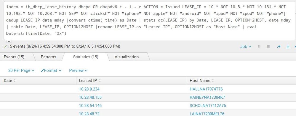

Since a picture speaks a thousand words here is what my current results get me:
As you can search my search gets me Date, Leased IP, and Host Name
I would like the Date field to contain only the date i.e 08/24/2016 and not the hour, minute and second. Is there a way to do that?
Thanks for any help you can throw my way,
P.

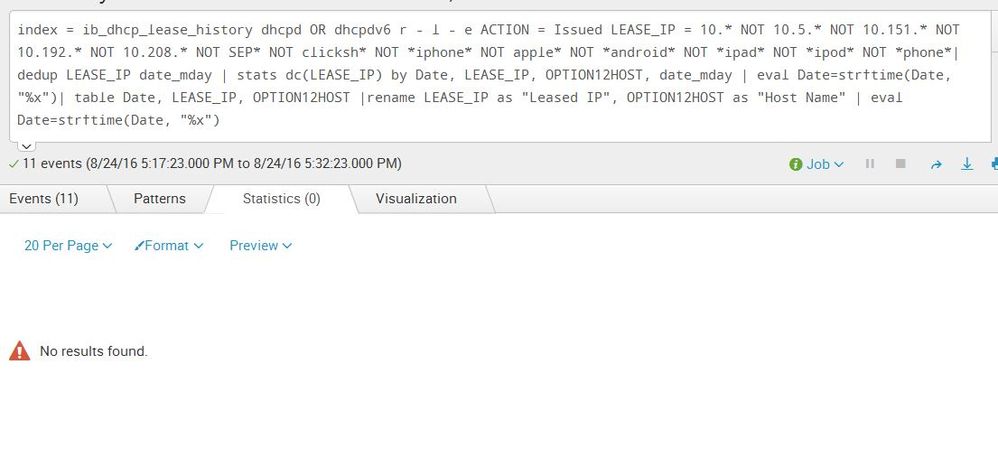

pboynton63
Thank you Sundareshr,
Here are the results of your suggestion:
It seems to have taken the date and time, and what I was looking for was just to remove the hour, minute, and second. I would still like the date e.g. 08/24/2016
But I think we are close!
Again my thanks,
P.
MuS
Skip the convert - after that you have a string and no longer an epoch value which is required by strftime() to work.
cheers, MuS
