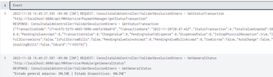

I need to put all the paragraphs together, to be able to see the entire process registered in each use case. I can only see all the events that are associated with a CardId (paragraphs in green), but I need to see the entire use case filtering by the CardId and not by the host (as I'm doing at the moment), since it brings me all the information of all use cases and I only need them by CardId.
The ideal is to be able to join all the paragraphs (the amount varies, depending on whether returns or other types of events have to be made), for each use case in particular, to which a single CardId corresponds. As I mentioned, each method starts with reading the card, brings up various events, and ends when a new card is registered.

Not all fields have a value in common. In the following image you can see a paragraph with the IdCard of the use case, but in the next paragraph, said IdCard is not shown, despite the fact that both paragraphs belong to the same use case. In short, I need to be able to observe all the paragraphs belonging to a single use case, regardless of whether or not they have a common field. All use cases start by reading a particular IdCard and end when a new IdCard is entered, but not all paragraphs have the IdCard field.

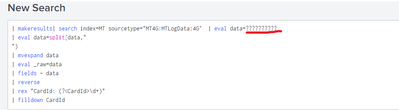

OMG!! Apparently this could be the solution. The previous paragraphs belong to a log called "MTLogData:4G"; I consult it in splunk in this way: sourcetype="MT4G:MTLogData:4G", but I have not been able to do the query correctly, I need it to take the log and not the text that it is searched for. Please, can you help me to make the search directly from the mentioned log and not on a text fragment? I've been trying for several hours, but I don't know what I'm doing wrong.

Can you teach me how to do it? please, I've been trying all day, in various ways, but I can't get it right, I'm still a newbie using Splunk, I've only been using it for a few months.

I guess my instructions weren't clear enough.  In the SPL I provided, REMOVE EVERYTHING UP TO AND INCLUDING
```Above creates demo data.  Delete IRL```
Then insert your code for reading MTLogData:4G log.
richgalloway
Replace the parts of my query from | makereults through and including 'IRL```' with the SPL that reads the MTLogData:4G log.

I have done it this way, among others, but I still have no success, the first "eval data=" is the one that is stopping me, I don't know how to do the query properly in this part
