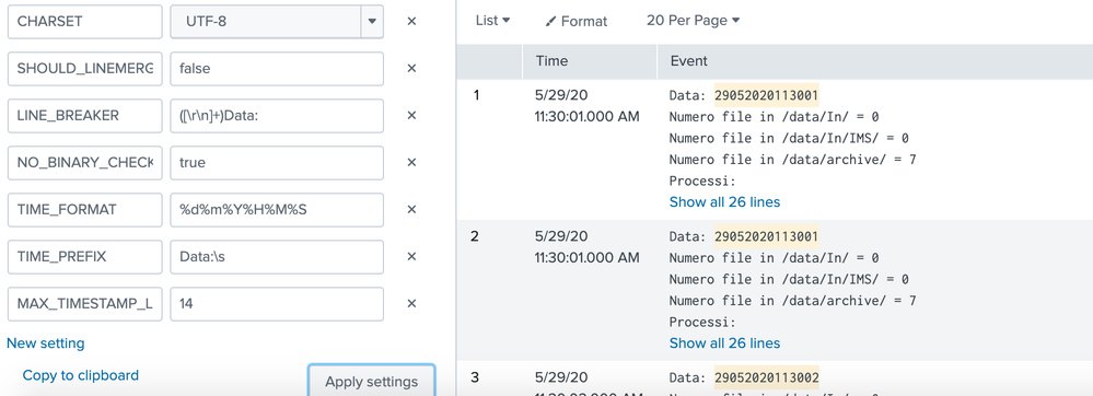

i need to have all this log in one splunk event. with that configuration, splunk parse the log in two events:

[ your_sourcetype ]
SHOULD_LINEMERGE=false
LINE_BREAKER=([\r\n]+)Data:
NO_BINARY_CHECK=true
TIME_FORMAT=%d%m%Y%H%M%S
TIME_PREFIX=Data:\s
MAX_TIMESTAMP_LOOKAHEAD=14
props.conf
@richgalloway 's setting is right.
