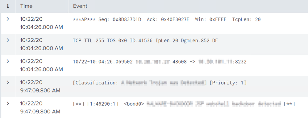

Hi,
I am trying to add Snort data into Splunk by monitoring barnyard2.alert file using Universal Forwarders.
[monitor:///var/log/barnyard2/barnyard2.alert]
sourcetype=snort_unified2
index=snort
As explained here https://community.splunk.com/t5/Getting-Data-In/Why-is-Splunk-line-breaking-a-single-IDS-Alert-event... , I added same settings to props.conf(Indexer and SH) but Splunk still ends up breaking each line as a separate event, as shown below:Snort_1.png

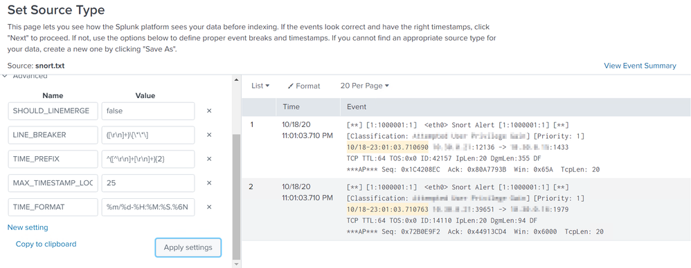

But when I try these settings by manually adding same input it works just fine.
Any ideas on what could be going wrong with props.conf?
