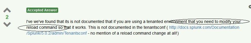

A similar qustion at Deployment Server - reload configs without restarting splunk
We also use /opt/splunk/bin/./splunk reload deploy-server after making changes to a deployment app or/and to the serverclass.conf file and it triggers a restart of the forwarder that got the changes.
Very interesting question.
Based on splunk reload deploy-server not updating bundles
it seems that the reload command might be modified -
reload
