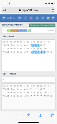

Using the clever regex from @thambisetty (and slightly modified), here is a SEDCMD that I have tested which works and does what you want:
SEDCMD=s/(?=[^\|]+\w{4}]$)./#/g

@cpetterborg Thank you for this. It worked 🙂
