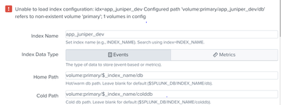

Not able to create same index in HF it is throwing this error.
  • manually add the index in the conf files on Hevy Forwarders. ---> Where to do this for particular data input? Please guide me
gcusello
Hi @Karthikeya ,
on the indexers you have the Volume thats not relevant on HFs: remove the volume defintion and use
$SPLUNK_DB/app_juniper_dev/db
$SPLUNK_DB/app_juniper_dev/colddb
Ciao.
Giuseppe
