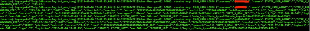

The first picture is my original logs
The second picture is my logs in the splunk
Now,we can see the splunk wrap my logs in the wrong places.
Please tell me how to set in the props.conf can solve this problem.

Hi,
Try this,
LINE_BREAKER = ([\r\n]+)\[[^\]]+\]\[\d{4}\-\d{2}\-\d{2}\s++\d{2}\:\d{2}\:\d{2}\,\d{3}\]\[tid\:
THat should break the events better for you

Hi perlish
There seems to be two problems. First the output of your logs has unwanted carriage returns in it. The second splunk is not recognising this as a multiline event. The latter can be fixed with the following stanza in props.conf. The time prefix looks complex but it is saying look for a line that starts with [ and the time should come after the second [

The line breaks will still be there and may cause fields to break in half. I suggest you look at how these logs are generated for the cause.

I tried this method but it seems did not work.
How can I set up the line breaker like a '\n'.

What are the current props.conf settings for this log? Have you tried BREAK_ONLY_BEFORE=[ems.ton]?

Yes,I have tried but did not work.
