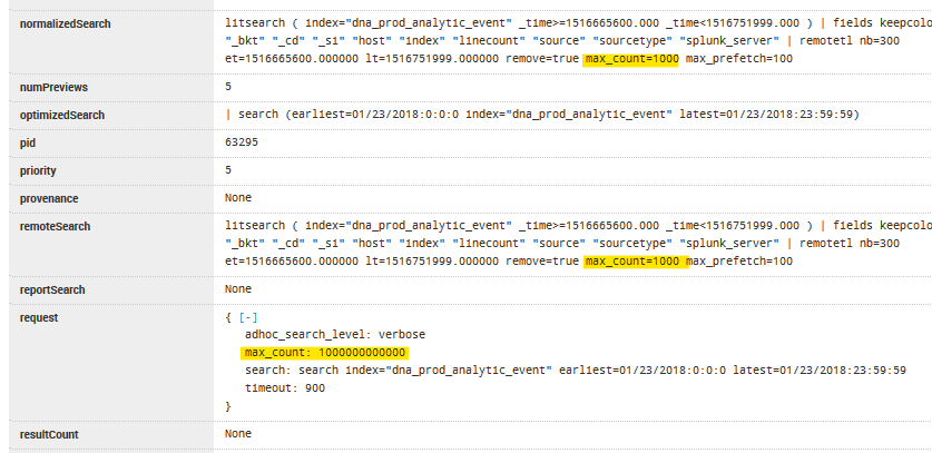

However, no matter what I set max_count to in the search request, Splunk normalizes this request to 1000. When I call the API to get the number of results in the data-set, it says that there are 1000.
Here is a screenshot from inspecting the job:
What is the best way to use the API to get a large dataset out of Splunk?

It seems that the export API endpoint streams results instead of saving them and so allows you to have much larger result sets.
The answer to the question is, therefore, not to use the /jobs/search endpoint to create a search job and then later go fetch the results. Instead, use export to stream it all over the wire.
