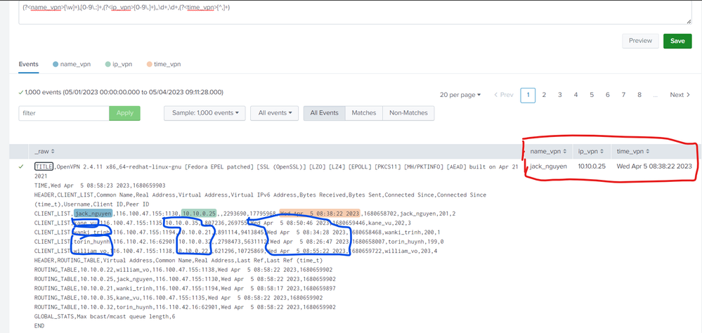

I have a log event and I want to extract like this:
I want to show it line the red line. How ever it just recive the first line in event. how to show all the blue line?
Thank you for your help.

Thanks, that helps a lot.
It's an interesting data set, multi-line with different CSV headers in the one event.
The following is a method that should meet your use case
... your search ...
| rex field=_raw "^(?:.+?[\n\r]){2}HEADER,(?<_raw>(.+[\n\r])+)HEADER"
| multikv forceheader=1
| table Common_Name Virtual_Address Connected_Since
It pulls out (rex) the CSV section you're interested in and then uses the multikv command to extract the data as single line events.
You can rename the output fields if you like too.

Hi @jacknguyen
It is easier to help if you copy and paste the whole event as text - place inside a preformatted style, or code sample </> helps too.
Screen shots like this, with big multi-line events make it far harder to help and get some SPL code working.
