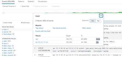

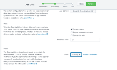

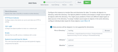

I have set up a continuous monitor of the /var/log directory and set the host to "vps"
Now when I am searching the oslogs index, I'm expecting all the logs to have the host value to be set as "vps" but that is not the case, instead of having one host "vps" I have two hosts "vps" and "ip-172-31-17-23" which is the hostname of my machine.  There is no additional input for the oslogs index, this is the only one that I've set.
What explains this anomaly and how can this be rectified ?
