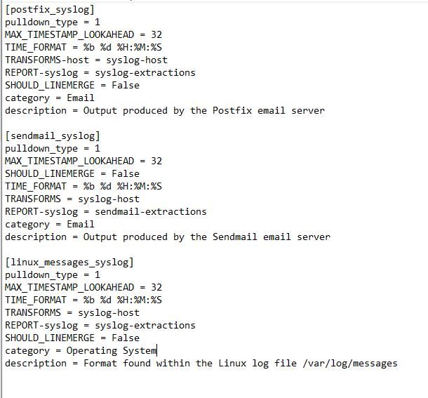

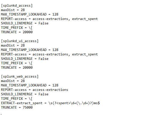

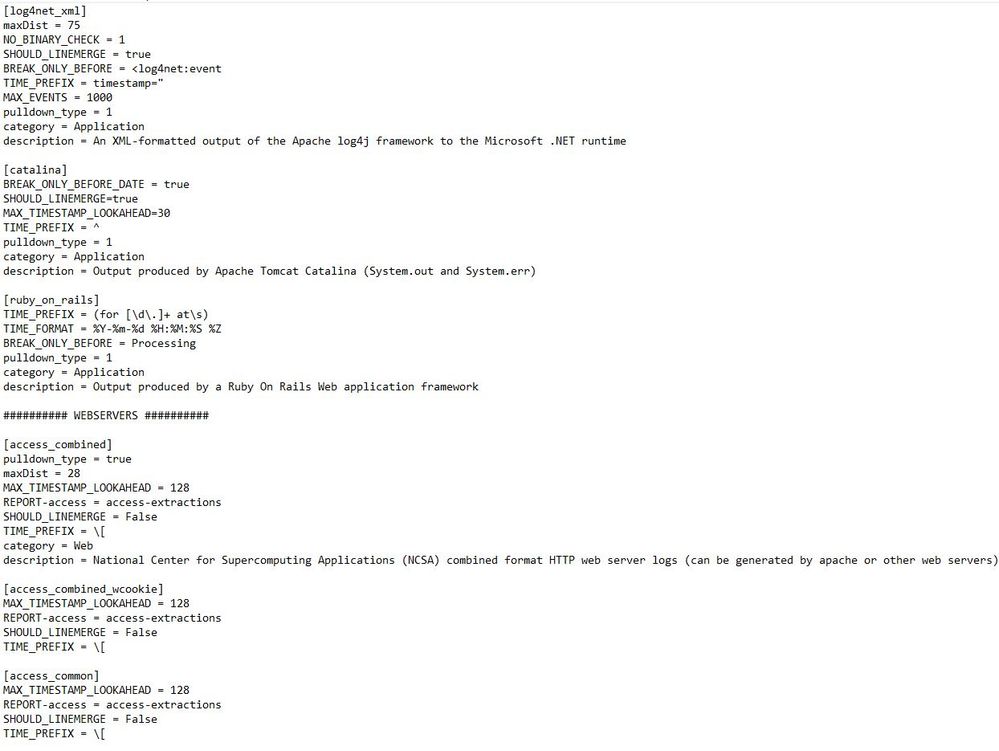

I have received the content of props.conf and I searched for both the keywords TIME_PREFIX & TZ but I found some entries for TIME_PREFIX only.
Please check the attached images and update back.
Even I searched for Avamar keyword but dont find any entries in the conf file and also for logging using syslog I have attached those contents too from the conf file.
Thanks
richgalloway
It's difficult to know if a TIME_PREFIX setting is correct without seeing sample data.  The props.conf stanzas that do not have a TIME_FORMAT setting probably need one.
If you can't find a stanza for Avamar (did you try btool?) then you probably need one.  Every sourcetype should have one.  The search results in your OP should say what sourcetype was used with the Avamar events.  Make sure there are props.conf settings for that sourcetype.
