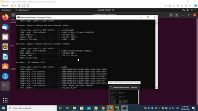

I tried to then set up the forwarder to forward traffic from Kali linux to go into splunk enterprize.... but for some reason it is showing in Splunk enterprize that a forwarder is set up from from IP 192.168.253.1 ... which I think is another VM.. ( on my main OS - windows I went into command prompt and did ipconfig.. and results are in the screen shot below).

Hi @Tonyrakus,
the problem is that you cannot (and don't need to) install Splunk Enterprise and Universal Forwarder on the same machine!
UF must be on a different server.
If you need to take logs from the first machine you can take them without installing UF on the same machine and it's easier thna UF because you can use the Web GUI.
in addition, you don't need ro run the above command if you have all in the sameserver.
