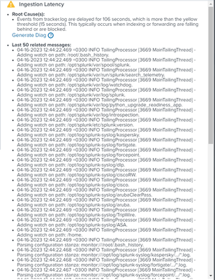

And in the GUI, in the "Health Status of Splunkd":
under the "Ingestion Latency":

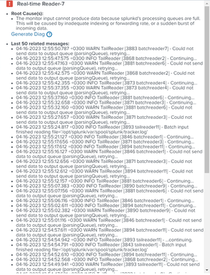

And under the "Real-time Reader":
what is the issue that I'm facing?
