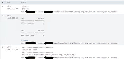

I have an issue where I can't get an event to break right.
The event looks like this
 2024.09.03.141001
 sqlplus -S -L swiftfilter/_REMOVED_@PPP @"long_lock_alert.sql"
TAG		  COUNT(*)
PPP_locks_count 	 0
TAG		  COUNT(*)
PPP_locks_count 	 0
 SUCCESS
 End Time: 2024.09.03.141006
Props looks like this:
[nk_pp_tasks]
SHOULD_LINEMERGE=false
LINE_BREAKER=End Time([^\*]+)
NO_BINARY_CHECK=true
TIME_FORMAT=%Y.%m.%d.%H%M%S
TIME_PREFIX=^.+[\r\n]\s
BREAK_ONLY_BEFORE_DATE = false
Outcome is this:
When the logfile is imported through 'Add Data' everything looks fine and the event has not been broken up in 3.
Any idees on how to make Splunk not break up the event ?
jesperbassoe
So it turns out the SQL doesn't write the entire event at once and Splunk therefore only reads part of the event.
It worked in our TEST because I dumped the log file and therefore the entire events were there.
The solution was :
multiline_event_extra_waittime = true
time_before_close = 10

Yes, but as I understand, that's not the issue. If you copy the same contents several times over into a single file and upload it to Splunk via "add data" dialog with the settings @jesperbassoe provided, it does get properly split into separate events. True, the final timestamp is getting discarded as it is treated as a linebreaker but apart from that the stream is properly broken into events.
The screenshot however shows the event butchered into separate parts which doesn't really match the LINE_BREAKER definition. So the questions are:
1) Where are the settings defined (on which components; and are there any other conflicting and possibly overriding settings)?
2) How is the file ingested (most probably by monitor input on an UF)?
jesperbassoe
@richgalloway You're right. Discarding End Time was a last desperate attempt to see if that made any difference
@PickleRick Settings are defined on indexers.

And file is ingested by monitor input on an UF and delivered directly to the indexers..
jesperbassoe
The solution was :
