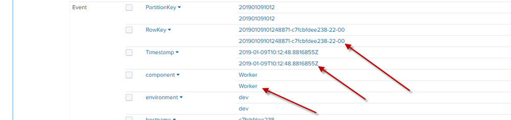

francoisternois
Thank again for your quick answer. Here is an example of what I'm facing. And I've no props.conf for this sourcetype. Maybe I should configure one indicating that it's cooked data ?

francoisternois
That's perfect ! Thank you !
francoisternois
Thank you ! It works very well ! But...
Now I have multivalue fields 😕
I guess both extracted on HF and indexer. Any ideas ?
harsmarvania57
Ultra Champion
Only first full instance of splunk is parsing the data so in your case only HF is parsing data. Can you please post your multivalue field sample data and what problem are you facing with it ? Also I'll suggest to remove config from Indexer if HF is parsing data.
EDIT: It maybe due to config on Indexer, so first remove config from Indexer and then check.
