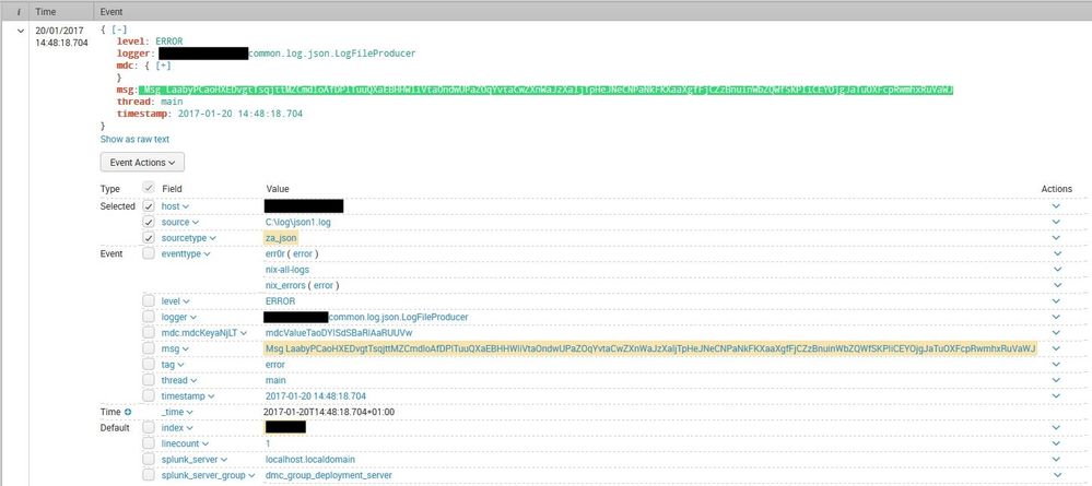

It has indexed everything properly (with the mdc fields) BUT i do not see them under the event BUT can search for them?! So if you look at my events from that sourcetype i see all the extractions EXCEPT the mdc kv fields. If i look at a particular Event (search for only that event) it shows the mdc fields as it should?!
See here:
Particular Event in the list of all events:
No mdc kv fields are here
Now just looking for that particular event in the search by adding the message as a search term (which is unique):
There we go, mdc kv fields are here
Its the same event, same source, same sourcetype -- what am i missing here? Is it some kind of limit which causing all the headache?

yeah, at least in my example, the mdc is being extracted by the syntax highlighting...
If I search verbose mode, it gets the mdc...and if I click on that value and add to search , it actually pipes it thru spath. So you were right, my previous examples were search time...but they weren't KV_MODE as I had that off....
It looks like the gui does auto extract of JSON with SPATH in the search results. I tried turning syntax highlighting off...will try and find out more about the voodoo at play here...
When you click the mdc and 'add to search' is it piping thru spath for you?

right, but when you add it...does it add | spath ? or does it add it as a kv pair?
when I add to search, my search becomes:
index=n00blab sourcetype="answers_json" host="n00b-noah-01"| spath "mdc.mdcKeybIwMa" | search "mdc.mdcKeybIwMa"=mdcValueNYUGJgYJaTFaWcdicara

Ok sorry i missed that - it becomes a kv pair as it should - so my search
index="skynet" sourcetype="custom_json_indexed" Msg GvuLnDhEXexLaaHmMHSaqQJyozYtFJAarNkkridVbsUHmcZagLNwPrsVvycpKoGsohXgnzyvAbrWLaZalFIasamdiPJwikfEBZraMpugIJaShabvEaidNRJakYjdeEIVKWMvqJDoAIJQcVhgKaISSVLYojjRaHNaSJcywvaaaYsaaassiVtmdBGWlqBEzGtHmqaaVk
become
index="skynet" sourcetype="custom_json_indexed" Msg GvuLnDhEXexLaaHmMHSaqQJyozYtFJAarNkkridVbsUHmcZagLNwPrsVvycpKoGsohXgnzyvAbrWLaZalFIasamdiPJwikfEBZraMpugIJaShabvEaidNRJakYjdeEIVKWMvqJDoAIJQcVhgKaISSVLYojjRaHNaSJcywvaaaYsaaassiVtmdBGWlqBEzGtHmqaaVk "mdc.mdcKeyaippQ"=mdcValueuvCvVphbipWgKdaagITQ
