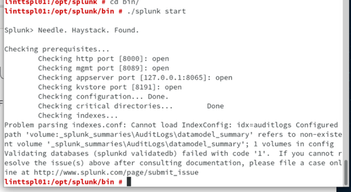

So i am in the process of migrating a distributed setup with 1 search head, 1 deployment/license server and 1 index server.
I am starting with just testing on the searchhead.
I have installed a fresh install of splunk enterprise on a new linux machine.
After that i zipped the splunk/etc folder from the windows machine, copied to the linux, unzipped and replaced the splunk/etc folder there.
This new linux splunk server doesnt have a connection to the other servers yet.
When i am trying to start it i get the following error:
Any ideas?
Tags (2)
gcusello
Hi @michaelnorup,
as you can see in the message, there are some paths in your conf files woth the windowsformat "\" instead in Linux you have to use slash "/".
SO, you have to check your conf files and manually modify the ones with windows path.

Ahh okay that makes sense with the \ to /.
I want all saved searches and dashboards etc to be migrated with here obviously, so would copying the entire etc folder be the way to go? Will have to fix the pathing is pretty tedius but nessesary.

I should be able to just copy the ENTIRE splunk/etc/ folder right? Then just change all the \ to / and be good?
About about users and roles? That should be good aswell? Some of them come from AD, but if the new server has an AD connection it should assign the roles fine right?
gcusello
Hi @michaelnorup,
yes, you can copy the entire $SPLUNK_HOME/etc folder, but if the new hostname if different than the old one, you have to manually replace the hostname value in:
  • $SPLUNK_HOME/etc/system/local/server.conf
  • $SPLUNK_HOME/etc/system/local/inputs.conf
roles are in $SPLUNK_HOME/etc/system/local/authorize.conf, users, as all unix systems, are in $SPLUNK_HOME/etc/passwd: you can manually copy those files from the old environment or manually add to the new system.
