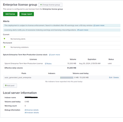

I have set the SH to be the License Master, and both machines point to the SH as License Manager, yet on the SH, I do not see any instance other than itself to be the indexer.

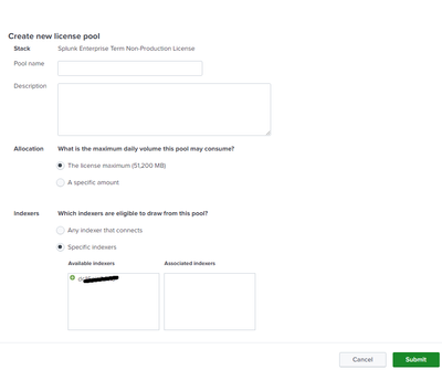

When i go to add a new pool, like i see it on our DMC, i can only add itself as available indexers

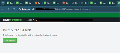

That's what I was thinking as well. But when I go to the Distributed Search, I get this message, like i cant add anything
And for ONE SH, that is def allowed with the free license. Ive reached out to our splunk rep to ask about the license.
