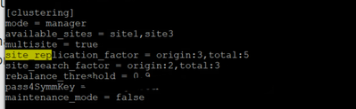

Hi Team,
I need to decrease the number of indexers used to half, in my current configurations we have site replication factor is 5 in total with origin:3 and site searchfactor is defined as 3 in total and origin:2.
My total number of indexers is 24 and I want to decrease the count of indexers to 12.
I want to have the complete process of reducing the indexer cluster size so that the buckets which have site information will not be impacted.
