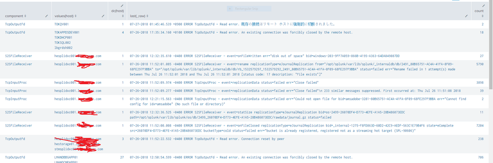

This hesplfwd002 is actually a heavy forwarder.I ran your search taht you gave and got the below details attached in the screen shot.The only thing I changed in the search is the host=*. The problem is with the indexer hesplidxc001.xxx.com ,how to get this up

Did you restart that instance yet ? I don't see screenshot here
vrmandadi
Builder
Please see in the question I have attached the screen shot there.Yes I have restarted
akocak
Contributor
I can see in 3rd row, you have that indexer is running out of disk space.
