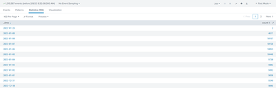

I have an deployment app that monitor log file from an external server that work fine since last year. But suddenly, since 26/1/2023 untill now, it can't index anything. Nothing changed from the server side or on my side either, the host still produce log file on a daily basis.
I also request to check the connection and restart deployment client but no improvement.

Curiously, the log stop after 9/1, comeback at 26/1 with only 2 line of log and then stop since that time.
The only change they made was change the name of the log from on access_worker6.log to access_worker_6_YYYY_MM_DD.log. But I in input.conf I put it as /*.log then it should catch it nonetheless.
