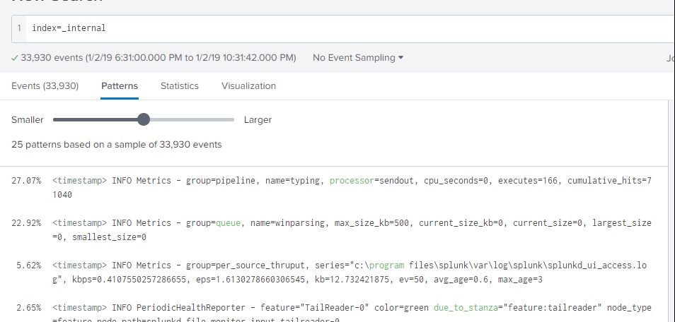

I need some guidance on interpreting the results of the pattern tab vs, the cluster command output. Basically, I do realize that the pattern tab output is an implementation of the cluster command. However, when I perform the below activities the results do not match and I am getting a bit lost here:
The above is just a rendition of index=_internal , run over the last 4 hours.

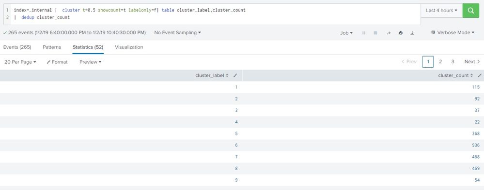

Now, when i run the cluster command with t-0.5. keeping the 'slider' in the pattern tab in the middle in the above snapshot. so as to coincide with t=0.5, in the cluster command , I receive the below output
My question is — The pattern tab says 25 patterns found, however, the cluster label is way above 25. Shouldn't they be the same? In other words, the # of patterns found should be equal to the unique clusters identified, given that the search is the same and run over the same time period with t=0.5/slider in middle of the pattern tab?

The patterns tab does sampling. If you set a fixed period of time, and do |head 1000 before the pattern tab or the cluster command, then you will often find the second most numerous cluster to be the largest pattern found, with the most numerous cluster being the "no pattern" group, assuming heterogenous event files.

@DalJeanis - Not quite sure what you are trying to say. How would you apply a head 1000 before the pattern tab?Do you mean something like index=_internal |head 1000 AND THEN check the pattern tab outputs? Wouldn't doing this contradict the pattern tab instructions - which says something like , less than 5000 events may produce results?
I do agree that it does seem to say that a part /sample of the total events is used by the pattern tab, but this is not very clear. From my 1st screen shot you can see that the pattern tab says that all 33930 events have been used to determine the pattern.
Basically, splunk does say that the pattern tab is an implementation of the cluster command (which is the agglomerative clustering) and not the k means/ db scan used in the MLTK app. The results should match / at least be in some sort of sync. My example avobe gives 25 patterns and 60+ clusters for the same query (namely, a simple index=_internal search) , this is too wide to be justified in terms of sampling issues/total number of events mismatch.

Check if the number of events for sampling is same for both (no of events scanned).
