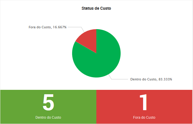

I have a dashboard with a pie chart . This chart has a contextual drilldown that displays a table with data of the clicked field.
The problem is that I'm displaying the count field with the label as follows (field." [ ".count." ]" and this value is passed to the drilldown. Since there is no field with this value, my table does not return anything.
I researched it and found that it is possible to use the value of a field for the token, but this did not work.
This doesn't work:
<drilldown>
   <set token="status_value">$row.statusCust$</set>
</drilldown>
in the search I do it, but the token does not solve to the value
search status_custo="$status_value$"
could anyone help?

Could you post your pie chart search and the drilldown search ?
markux
Hello somesoni2,
Thanks for the answer. Follow the required codes.
Pie Chart Code:
    <chart>
            <search>
              <query>sourcetype="relatorioGeral" considerar="Sim" status_projeto="Execução" codigo != NULL
                             categoria="Projeto" cliente="$tk_cliente$" $tk_gp$
                           | dedup codigo
                           | eval statusCusto=if(total_custo_projetado > total_custo_estimado,
                              "Fora do Custo", "Dentro do Custo")
                           | stats count by statusCusto | eval statusCusto=statusCusto ." [".count."] "</query>

            <drilldown>
              <set token="status_value">$click.value$</set>
            </drilldown>
          </chart>
Row Depentend:
    <row depends="$status_value$">
        <panel>
          <table>
            <title>Projetos $status_value$</title>
            <search>
              <query>sourcetype="relatorioGeral" status_projeto="Execução" codigo != NULL categoria="Projeto"
                cliente="$tk_cliente$" $tk_gp$ considerar="Sim"
                | dedup codigo
                | eval status_custo=if(total_custo_projetado > total_custo_estimado, "Fora do Custo", "Dentro do Custo")
