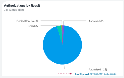

Currently using Dashboard classic and added Markdown Text to the bottom of my pie chart to inform the user when the data was last update.  Is there a way in the Markdown Text to format job.lastUpdated? It is currently showing in Zulu.
I was also thinking of putting it in the description field, if possible.

If its for a dashboard studio dashboard then you can use an additional search to convert the time format back to unix timestamp and then to whatever friendly time format you like, such as:

You are correct.  This is a Dashboard Studio in Absolute (not Grid).  I will try out your suggestion tonight.

Any thoughts why it is showing in GMT?  It is currently 4 hours ahead, I am EST.
"ds_LYYZ83TP": {
   "name": "LastUpdatedAuthByResults",
   "options": {
      "enableSmartSources": true,
      "query": "| makeresults | eval _time=\"$AuthorizationsBySource:job.lastUpdated$\", unixTimeStamp=strptime(_time, \"%Y-%m-%dT%H:%M:%S.%QZ\"), friendlyTime=strftime(unixTimeStamp,\"%Y-%m-%d %H:%M:%S\")"
   "type": "ds.search"
My user preferences have my Time Zone as (GMT-400) Eastern Time (US & Canada)
My current time is 19:18:01

Just following on from my last message - are you sure this is a classic dashboard and not Dashboard Studio dashboard? Classic XML dashboards dont have the ability to overlay markdown quite like you have in your screenshot?
I'll look at putting together a solution based on Dashboard Studio in the meantime.

You could set a token with eval such as:
<search id="base">
  <query>index=something etc..etc...</query>
  <done>
    <eval token="lastUpdated">strftime(now(),"%d/%m/%Y, %I:%M %p")</eval>
  </done>
</search>
Then you could reference with $lastUpdated$
