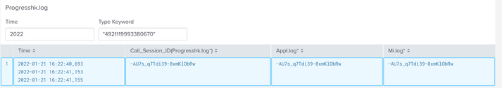

I am very confused with drilldown right now. I hope to set three different search commands to three columns on the table using drilldown!
But right now, when I click one of these cells, it will jump to one result. I don't know how I could edit the simple XML to feed the requirements.

Here's the original source XML:
<drilldown>
<link target="_blank">search?q=index=%22hkcivr%22%20source=%22/appvol/wlp/DIVR01HK-AS01/applogs/progresshk.log*%22%20$click.value2$&amp;earliest=0&amp;latest=</link>
</drilldown>
I don't know how to edit it as you suggested!

Jennifer
Hi, Giuseppe!
It still doesn't work well!
When I click on the column of appl.log* and mi.log*, it will still to the same search as the search of column of progresshk.log* .
Basically, clicking on the whole row, it will come to the same result!
