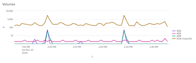

As @gcusello  and @PickleRick noted, we use the Line Chart visualization to produce a run chart and then save the visualization to a new or existing dashboard. We can also create the Line Chart directly using the classic and Dashboard Studio editors.
All of the examples used above produce a chart similar to the following (shown in log scale):

Clicking the "total requests" series will generate the following search, which will return no results:
index=web sourcetype=access_common status="total requests"
We can handle this case using condition elements within the drilldown element:
<drilldown>
  <condition match="$click.name2$ == &quot;total requests&quot;">
    <link target="_blank">search?q=index%3Dweb%20sourcetype%3Daccess_common%20status%3D*&amp;earliest=$earliest$&amp;latest=$latest$</link>
  </condition>
  <condition match="$click.name2$ != &quot;total requests&quot;">
    <link target="_blank">search?q=index%3Dweb%20sourcetype%3Daccess_common%20status%3D%22$click.name2$%22&amp;earliest=$earliest$&amp;latest=$latest$</link>
  </condition>
</drilldown>
Clicking the "total requests" series will now generate the following search:
index=web sourcetype=access_common status=*
Note that using a custom link target allows us to use any of the example searches shown above assuming the underlying events share the same index and source type. Data models, tags, default search indexes, and other configuration techniques can help standardize or simplify our approach to searching data.
Dashboard Studio (not shown) provides similar functionality; however, conditional drilldowns to custom URLs are not supported.
