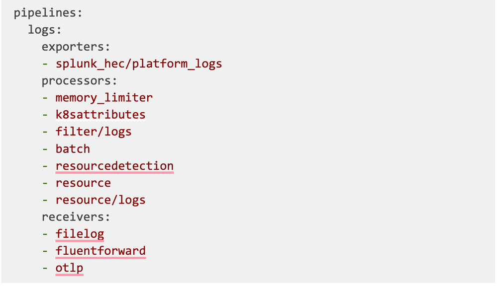

Viewing the pipelines configured in SOCK
Before we cover how to overwrite your pipelines, let’s start with how you can view the pipeline. The final config is the result of your configuration in values.yaml, as well as the default configuration that is delivered by SOCK. The config’s yaml file is in the pod’s configmap.
As logs are generated by the agent, you can look at the agent’s config, the command is:
Where my-splunk-otel-collector-otel-agent is the configmap’s name - it might differ in your case, especially if you chose a different name for an installation versus one from the Getting Started docs. You can take a look at a configmaps you have with the command:
An output example for a default namespace would be:
After successfully running the describe command, scroll all the way down until you see the pipelines section. For logs, it looks more or less like this:
Now you know what components your logs pipeline is made of!
