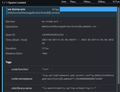

The third trace is being generated by the spring-scheduling instrumentation, presumably to handle some websocket or messaging/routing internals:
All of these separate traces, none of them linked. We can make this better!
