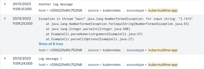

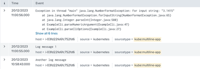

Again we use the same Java log file that produces such a result in Splunk:
This time we need to apply multiline config as a part of filelog operators.

source_identifier is attributes["log.file.path"] as this is the only differentiator we have at this point. Applying this config results in correct log processing:

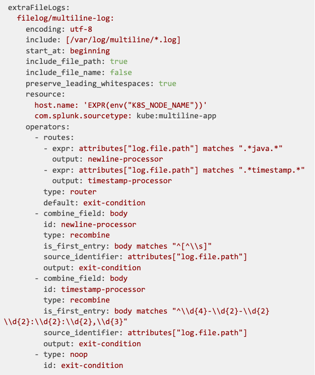

Scenario 2 - recombine and a router
This time let’s combine two cases - java logs and the logs with a timestamp. Such a config requires defining a router to not unnecessarily run all the logs through the same operators. Additionally, in some cases running regex on a log that doesn’t match might result in runtime errors resulting in sending nothing to Splunk.
After applying this config:
Both files were processed correctly:

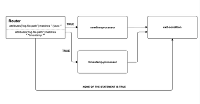

Here an important thing to remember is that operators are being executed one by one, so we have to define noop (the operator that does not do anything) as an exit condition. The diagram looks like this:
General notes
There are a few things to remember when creating your filelog pipeline:
  1. Every regex pattern must be double-backspaced. When the multilineConfigs option is used, this is automatically done by the Helm mechanism. Remember to do it manually or you might end up with such issues: failed to compile is_first_entry: invalid char escape (1:32)
  2. It is important to set output and default fields in routers. For example - if we didn’t do it in the previous example and the log would match the first expression it would be passed to the newline-processor, but then the timestamp-processor would be triggered as well - because it is next in a sequence.
  3. There are better ways to create expression patterns than attributes["log.file.path"] matches ".*java.*", we should generally avoid greedy regexes whenever possible. You can learn more about expression language to find out a better way that suits your needs.
