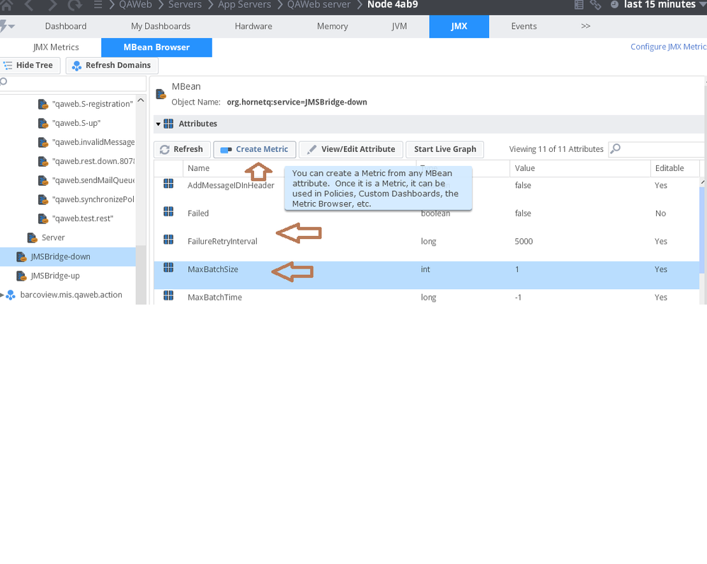

Hi Joakim,
Can you click "Mbean browser" in the same screenshot provided to us and check what Hornetmq mbean categories and and object pattern of the mbeans exposed are in sync with JMX  config under Configure -> Instrumentation -> JMX screen you are referring ?
If the rule and object pattenr of mbeans exposed of target mbeans in "mbean browser" are not in sycn , you would need to update either jmx rule existing as per object pattern of mbeans exposed in mbean browser Or create rules from mbean browser itself, Let us know if that information helps.

Hi,
The object pattern is in sync with the Mbean in the JMX MBean browser.
I have one rule created directly from the MBean browser called 'S-Up Queueu' Messages and the other one is a default appdynamics rule. Both object patterns are correct conform the Mbean browser. See screenshot.

Can you export jmx config xml for config have both the rules from Configure -> JMX  -> select config having the two ruled configued (default and custom) and click "export" option in controller UI
And also  provide screenshot from node dashboard -> JMX -> MBean browser and provided screenshots for the mbean in view with same object pattern in mbean browser in addition to agent logs from affected agent node where you provide screenshot from mbean browser from node dashboard to assist you better.
