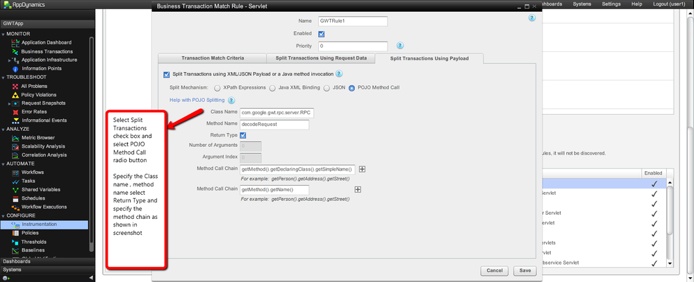

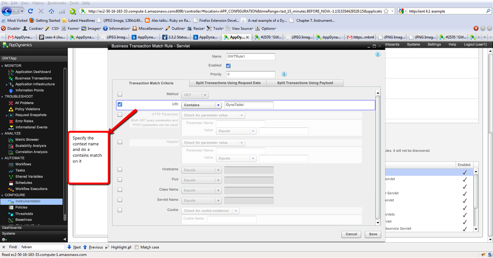

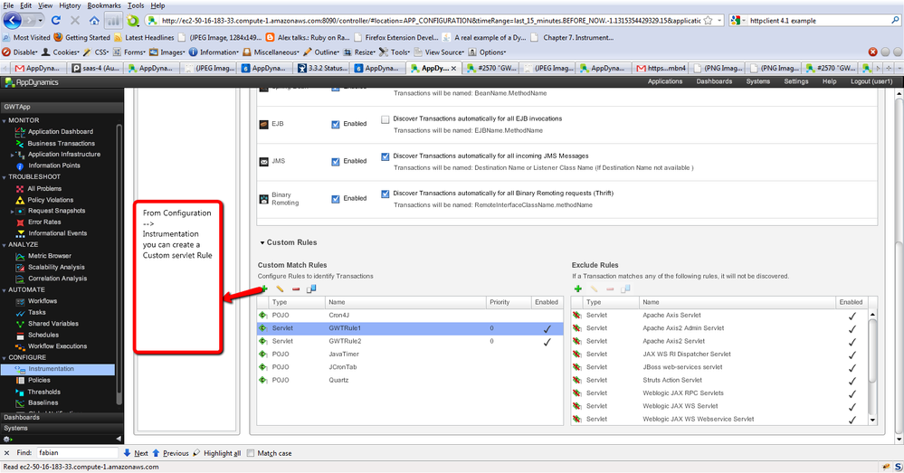

Refer to attached screenshot for Servlet Custom rule for GWT API, refer rule 1 configuration.
1) Go To Configuration --> Instrumentation as show in gwt-custom-rule.png . and create custom servlet rule
2) Specify the uri. In your case please specify the url contains rule and mention the context name in the text box. as show in GWT-Rule.1.png.
3) Go To 3 rd tab "Split Transaction using Payload tab" as shown in GWT-Rule.1.1.png file.
You need to specify following things in the pop up window.
Class name : com.google.gwt.rpc.server.RPC
method name : decodeRequest
Select the return type check box
Method Call Chain : getMethod().getDeclaringClass().getSimpleName()
Click on + icon and add one more chain method call Chain : getMethod().getName()
4) Save the rule.
5) Repeat the step 1 and 2 and create one more rule. for this rule following Params should be configured
Class name : com.google.gwt.user.server.rpc.RPC
method name :decodeRequest
save this rule.
Generate load on rule defined and see how it goes with BT detection, Please change the rule value as per your requirement Or define custom pojo rule if the provided settings does not help and see how it goes.

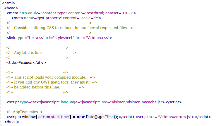

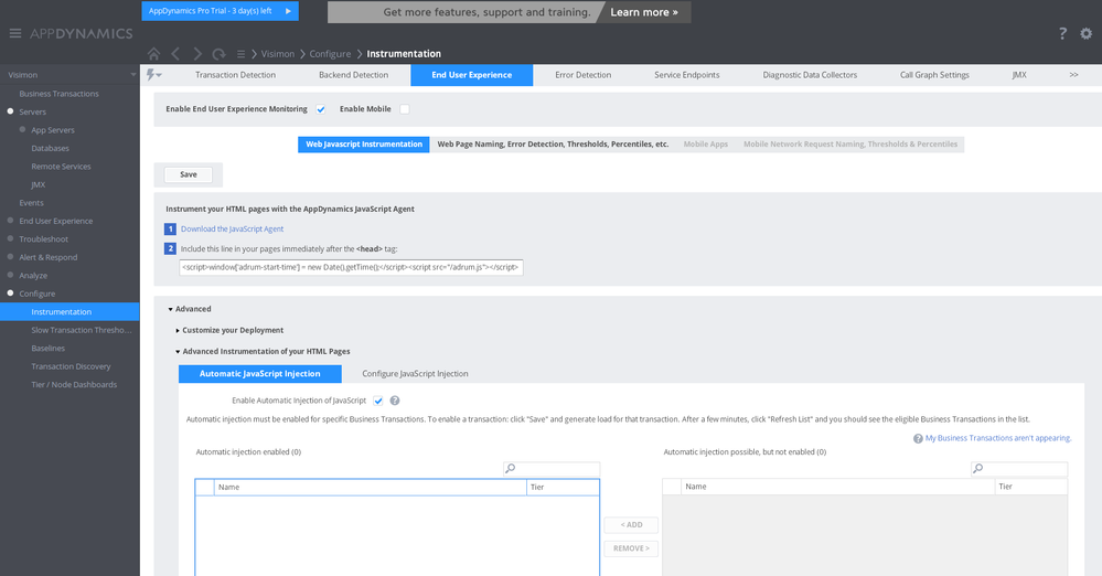

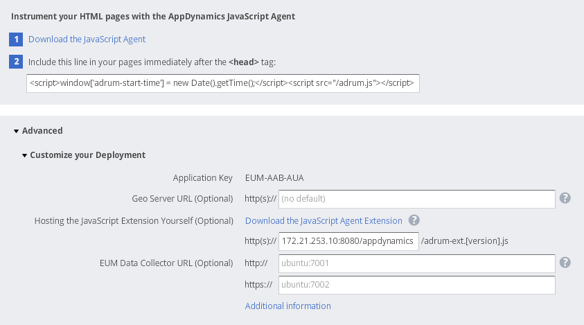

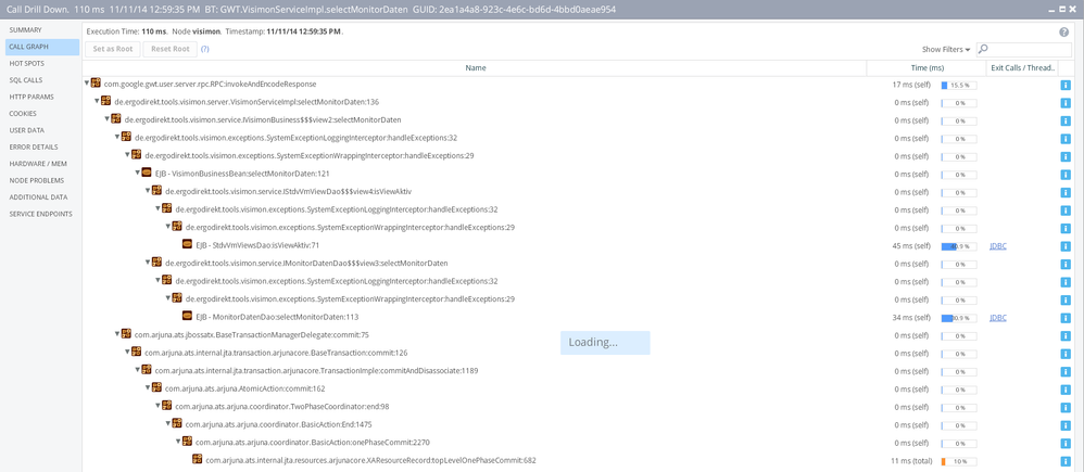

Hi Arun,
my question is, where can i find my client-calls from gwt. All i can see in the business transactions are the call into the server-part of gwt.
All calls inside the client are not visible.
I think i am missing some konfiguration. Maybe i must use the Web End User Expirience Management.

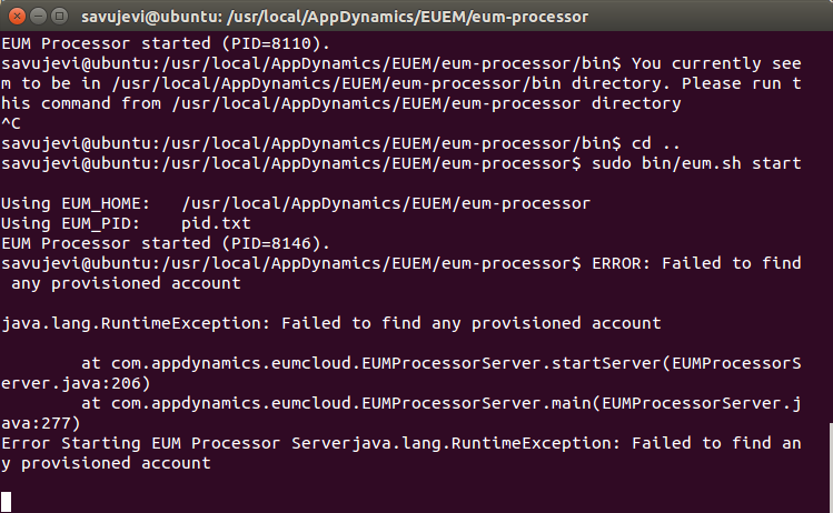

I have tried to start this management on my maćhine with following error:

Thank you for your help and patience.

Your understanding is right on client calls missing given that the client calls are not part of the JVM with agent configured and runs at browser end and EUM manual injection should help to monitor browser performance statistics.
Regarding eum processor error, Can you please provide the following details to debug further:
1) Please check whetehr the eum_db schema is present in the controllers embedded mysql database, find steps listed below to check the same:
shell> cd <controller>/bin/
shell> ./controller.sh login-db
mysql> show databases;
You should see output having eum_db listed as below:
eum_db
2) Please confirm the eum_db exists and if exists check the database tables under the eum_db schema as shown below:
mysql> use eum_db;
mysql> show tables;
3) Please issue provision-license script:
shell> cd <eumeum-processor-dir>
shell> ./bin/provision-license <path-to-license-file>
as stated in doc link  https://docs.appdynamics.com/display/PRO39/Install+the+On-Premise+End+User+Experience+Management+Pro...
Let us know if that information helps.
Regards,
Arun

Hi Arun,
after a reinstallation of the EUMProcessorServer it starts now without errors.

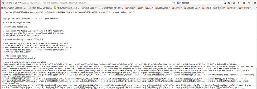

I have  donwloaded the adrum.js an integrated it in my gwt-application.
Than i integrated the code-line for the script in my html-file (there is only one).
I installed a war-file which includes the adrum-ext.js on my jboss-server.
My instumantation looks like this:
But i can't see gwt-client-stacktrace in the business-transaction. Is there a log-file-entry ? Do i miss a configuration.
Thank you for your help and your patience.
