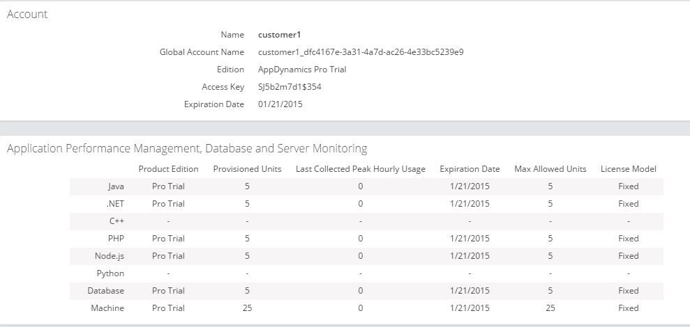

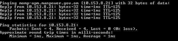

Please provide the ping/telnet/ view from browser tab with UI URI in view also send the screens from Setup -> license screen to see if it is single or multitenant as well

HI AppDynamics Community,
As your requirement this ping/telnet/ view & license screen :
telnet momp-apm 8181
license screen:

If the controller host used for .net machine agent is "momp-apm" and ssl-enabled flag is set to true and port 8181 is not blocked by any firewall rule as we do not see output of telnet command in your last update, please do restart instance and see if issue persists.
