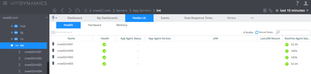

Here is a snapshot of the servers that show up in our AppD console:

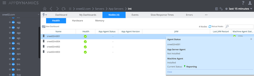

One more interesting thing here is that when I click on the UP icon of any of the node machine agent status, it indicates that App Agent is not installed. Please find the snapshot below:

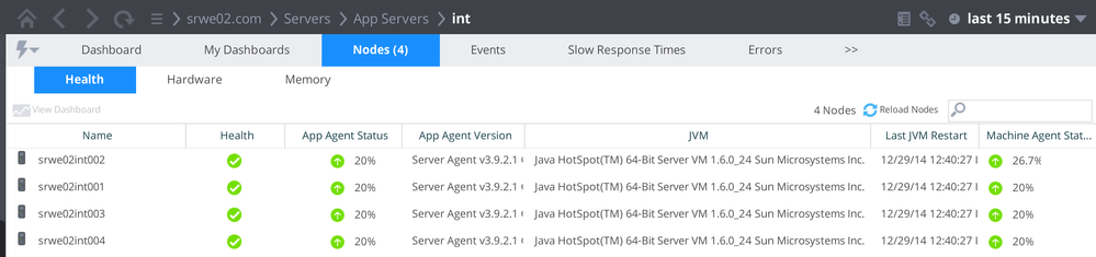

Thank you Frank for a quick response. I did see that issue is with user and permissions on /opt/appdynamics folder being the root cause. I have corrected the user permissions and now both appdynamics and muleESB start as same user and that helped in starting the appAgent in first place.
