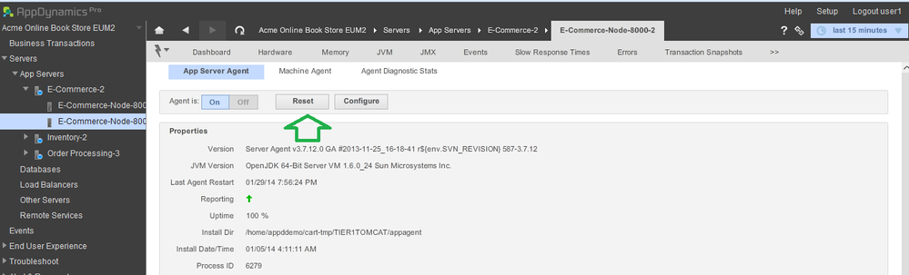

Agent have internal limit and will get reset on agent restart / reset and we request you to do agent reset (this does not require restart and helps in resetting agent limits back) as referred in below screenshot:
And if you still see the issue we request you to send the agent logs which helps to debug the issue to find the root cause.
