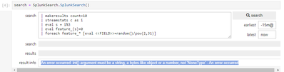

I wanted to experiment with Splunk's Deep Learning module to perform some tasks.
As mentioned in the "barebone_template" there are two methods to pull data from splunk in.
Because I want the data to be live, I want to be able to run a search inside the Jupiter notebook itself, hence proceeding with method 1.
Method 1 is done using Splunk's "dsdlsupport" Python library. But when I used the same commands they have in their template, it throws the following error for their default settings:
I wanted to check if someone has faced/solved this issue already before diving into their source code myself.

Part 2 - More details in case you are curious
Execute the following code in your jupyter notebook. Here you can inspect all os variables.
import os
os.environ
For us of interest are the following.
os.environ["splunk_access_host"]
os.environ["splunk_access_port"]
os.environ["splunk_access_token"]
If you haven't fixed the issue yet, os.environ["splunk_access_enabled"] should return "false". You most likely started the container before you made the settings as I described in part 1. These os.environ variables are important, since the function that lets you pull data from Splunk relies on them. The error in your screenshot "An error occurred: int() argument must be a sting, ..." stems from the fact that the SplunkSearch() function has no values for host/port/token.
import libs.SplunkSearch as SplunkSearch
search = SplunkSearch.SplunkSearch()
You find the source code for the SplunkSearch function in your Jupyter Lab here: /notebooks/libs/SplunkSearch.py. Somewhere in the upper section of this Python code, you see the following.
if "splunk_access_enabled" in os.environ:
   access_enabled = os.environ["splunk_access_enabled"]
      if access_enabled=="1":
         self.host = os.environ["splunk_access_host"]
         self.port = os.environ["splunk_access_port"]
         self.token = os.environ["splunk_access_token"]
As you can see in the code above, the SplunkSearch.py reads the host, port, and token you entered on the settings page if you also set Enable Splunk Access: Yes.
If you are familiar with Splunk's REST API, you recognize that host, port, and token are necessary values to establish a connection from your notebook to Splunk to eventually retrieve search results for your query. I skip the details, but here are a couple lines from SplunkSearch.py that illustrate what packages are used, the connection that is made, as well as the search query that is initiated.
import splunklib.results as splunk_results
import splunklib.client as splunk_client
self._service = splunk_client.connect(host=self.host, port=self.port, token=self.token)
# create a search job in splunk
   job = self.service.jobs.create(
   query_cleaned,
   earliest_time=earliest,
   latest_time=latest,
   adhoc_search_level="smart",
   search_mode="normal")
I hope this helps. Regards,
Gabriel
