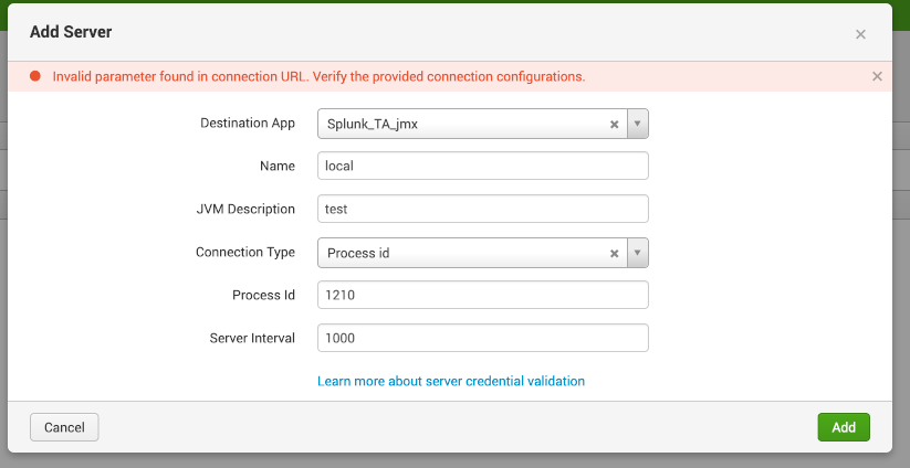

I'm installing splunk enterprise (single instance) on my mac, then i install the JMX add-on from the Web UI.
All local, but when i try to add server using 'process id' it says
where did i go wrong? The process itself is visible from jvisualvm
Update:
OK...now i'm able to connect. using other types of connection
Specific protocol >> "use URL directly"
service:jmx:rmi:///jndi/rmi://localhost:9999/jmxrmi
need to add this parameter on target jvm:
-Dcom.sun.management.jmxremote=true
-Dcom.sun.management.jmxremote.port=9999
-Dcom.sun.management.jmxremote.authenticate=false
-Dcom.sun.management.jmxremote.ssl=false
kamlesh_vaghela
@raisomain
Are you able to configure pid 1209 ?
raisomain
Haven't try it, but i can't connect using processId...even though everything is local
