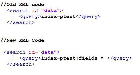

sunilsk1
I had a similar issue with my post process searches in my dashboard. I piped the "|fields *" and it helped . the dashboard showed the charts.. thanks
My xml was getting truncated in this textbox so i have uploaded an image.
