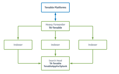

 The latest docs are at https://docs.tenable.com/integrations/Splunk/Content/Welcome.htm which they have recently updated, there is a great diagram to show where things should be installed:
In short, the Tenable Add-On for Splunk should be installed on your SH and HF (with inputs created on HF, or pushed out via your deployment server to HF if appropriate) and then install the Tenable App for Splunk on just the SH).

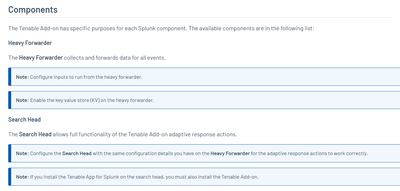

kiran_panchavat
@gheller Inputs must be configured to run from the Heavy Forwarder. The Search Head is used for dashboards and adaptive response actions, but it relies on data collected and forwarded by the Heavy Forwarder.
It's important to enable the KV Store on the Heavy Forwarder to support the add-on's functionality
Tenable and Splunk Integration Guide
The Tenable Add-on has specific purposes for each Splunk component.
Components
Install the add-on on both the Heavy Forwarder and the Search Head but create data inputs only on the heavy forwarder. https://splunkbase.splunk.com/app/4060
Install the app exclusively on the Search Head. https://splunkbase.splunk.com/app/4061
