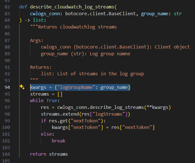

I'm working with the Splunk Add-on for AWS on Splunk Cloud, and I’ve run into an issue when trying to collect CloudWatch Logs from a cross-account AWS setup.
After digging through the Python code inside the add-on, I discovered that it uses the logGroupName parameter when calling describe_log_streams() via Boto3. However, in cross-account scenarios, AWS requires the use of logGroupIdentifier (with the full ARN of the log group) — and you can’t use both parameters at the same time.
So, even though AWS allows log collection across accounts using logGroupIdentifier, the current implementation in the add-on makes it impossible to use this feature correctly.
I was able to identify the exact line of code that causes the issue and verified that simply replacing "logGroupName" with "logGroupIdentifier" solves the problem.

To answer your question, you cannot make changes to files from Splunkbase apps in SplunkCloud. Whilst you could clone to app and upload with a unique ID with the amendments, you would be creating a supportability and maintence nightmare for yourself unfortunately.
I think the best solution at the moment would be to raise it as a bug with Splunk Support and see if they can give you a timeline on a fix.
In the meantime I will see if I can test this change with a non cross account collection.
