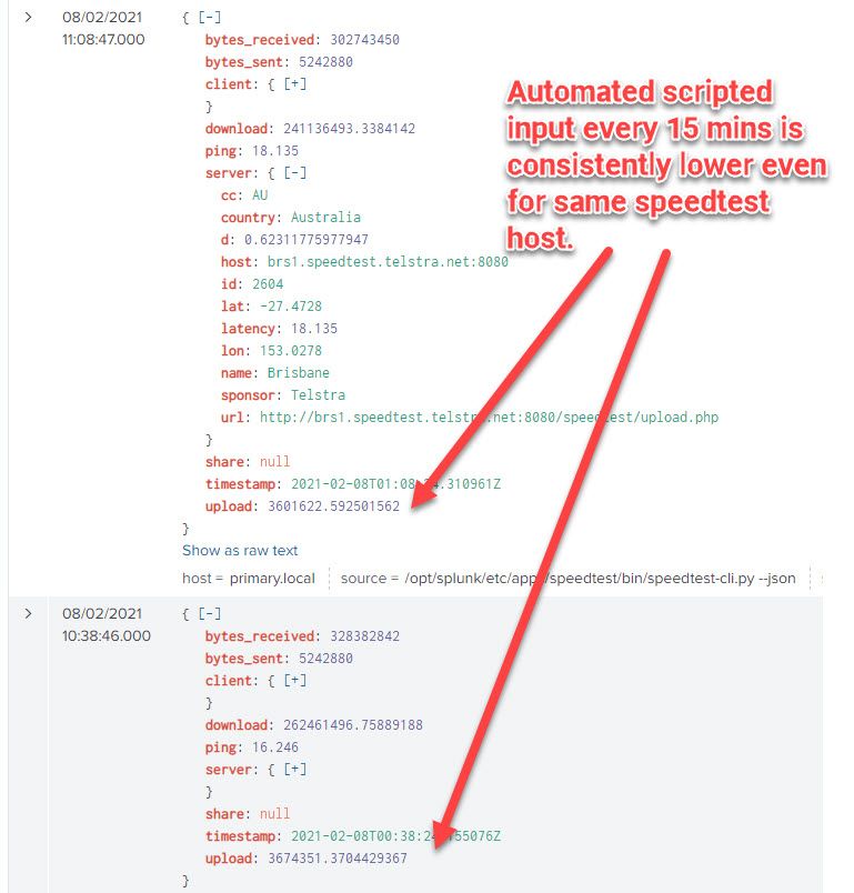

Whenever Splunk runs it as a scheduled scripted input the upload value returns ~3.5Mbps.

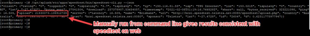

When I manually run the script from the same server it returns ~21Mbps
{"client": {"rating": "0", "loggedin": "0", "isprating": "3.7", "ispdlavg": "0", "ip": "193.116.81.55", "isp": "TPG Internet", "lon": "153.0215", "ispulavg": "0", "country": "AU", "lat": "-27.4732"}, "bytes_sent": 27787264, "download": 251570694.55484477, "timestamp": "2021-02-07T23:46:05.028139Z", "share": null, "bytes_received": 315446696, "ping": 16.562, "upload": 21321234.56928962, "server": {"latency": 16.562, "name": "Brisbane", "url": "http://brs1.speedtest.telstra.net:8080/speedtest/upload.php", "country": "Australia", "lon": "153.0278", "cc": "AU", "host": "brs1.speedtest.telstra.net:8080", "sponsor": "Telstra", "lat": "-27.4728", "id": "2604", "d": 0.62311775977947}}
Running it from desktop it returns ~21Mbps  - https://www.speedtest.net/result/10890590348

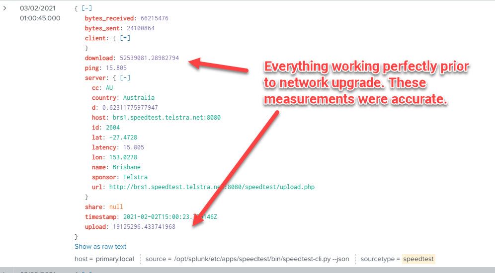

This was working just fine until my ISP upgraded the network last week. Previously I have 50Mbps down and 23Mbps up and the scripted input was accurately reflecting the measurements.

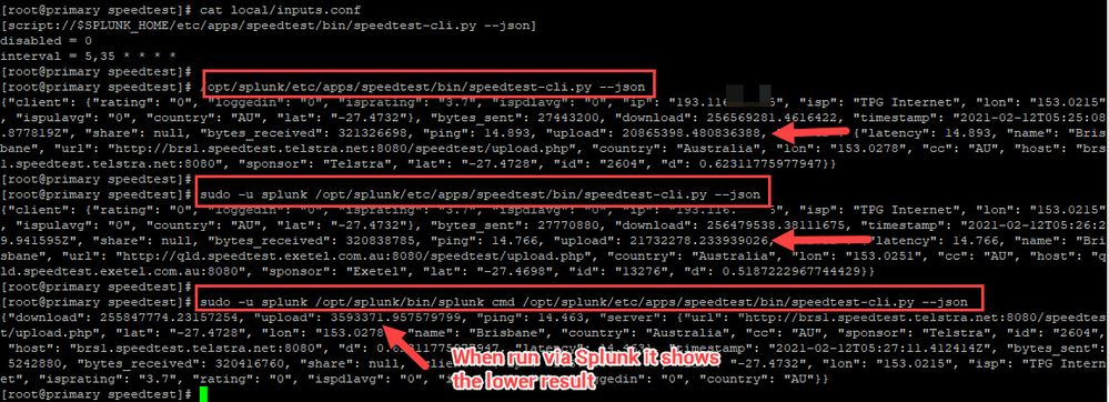

speedtest-2021-02-12_15-27-54.jpgThe plot thickens.
  1. Normal run of script - OK
  2. Run script as Splunk user - OK
  3. Run script via Splunk binary - Lower result. JSON format slightly different order too.
Maybe something to do with Splunk's Python?????
I'm running Splunk 8.1.2 (build 545206cc9f70)
Edit: I think I found the issue
Manually run with
  1. Python2 - OK
  2. Python3 - Lower result
cameronjust

# Python 2 Run
DEBUG: Upload Start:1613343269
.................................................................DEBUG: Upload Timeout: result=114688
DEBUG: Upload Timeout: result=458752
DEBUG: Upload Timeout: result=974848
DEBUG: Upload Timeout: result=483328
DEBUG: Upload Stop:1613343279
DEBUG: Bytes sent:[524288, 524288, 524288, 524288, 524288, 524288, 524288, 524288, 524288, 524288, 524288, 524288, 524288, 524288, 524288, 524288, 1048576, 1048576, 1048576, 1048576, 1048576, 1048576, 1048576, 1048576, 1048576, 1048576, 1048576, 1048576, 1048576, 1048576, 1048576, 974848, 483328, 458752, 114688, 0, 0, 0, 0, 0, 0, 0, 0, 0, 0, 0, 0, 0]
DEBUG: Bytes sent:26148864
DEBUG: Upload Value:20746227
Upload: 20.75 Mbit/s
DEBUG: Results:
{'client': {'rating': '0', 'loggedin': '0', 'isprating': '3.7', 'ispdlavg': '0', 'ip': '193.116.x.x', 'isp': 'TPG Internet', 'lon': '153.0215', 'ispulavg': '0', 'country': 'AU', 'lat': '-27.4732'}, 'bytes_sent': 26148864, 'download': 0, 'timestamp': '2021-02-14T22:54:27.902614Z', 'share': None, 'bytes_received': 0, 'ping': 14.774, 'upload': 20746227.40552687, 'server': {'latency': 14.774, 'name': 'Brisbane', 'url': 'http://qld.speedtest.exetel.com.au:8080/speedtest/upload.php', 'country': 'Australia', 'lon': '153.0251', 'cc': 'AU', 'host': 'qld.speedtest.exetel.com.au:8080', 'sponsor': 'Exetel', 'lat': '-27.4698', 'id': '13276', 'd': 0.5187222967744429}}
# Python 3 Run
.DEBUG: Upload Start:224944
..DEBUG: Upload Timeout: result=524288
DEBUG: Upload Stop:224955
DEBUG: Bytes sent:[524288, 524288, 524288, 524288, 0, 0, 0, 0, 0, 0, 0, 0, 0, 0, 0, 0, 0, 0, 0, 0, 0, 0, 0, 0, 0, 0, 0, 0, 0, 0, 0, 0, 0, 0, 0, 0, 0, 0, 0, 0, 0, 0, 0, 0, 0, 0, 0, 0, 0, 0, 0]
DEBUG: Bytes sent:2097152
DEBUG: Upload Value:1574428
Upload: 1.57 Mbit/s
DEBUG: Results:
{'download': 0, 'upload': 1574428.9733984023, 'ping': 13.135, 'server': {'url': 'http://brs1.speedtest.telstra.net:8080/speedtest/upload.php', 'lat': '-27.4728', 'lon': '153.0278', 'name': 'Brisbane', 'country': 'Australia', 'cc': 'AU', 'sponsor': 'Telstra', 'id': '2604', 'host': 'brs1.speedtest.telstra.net:8080', 'd': 0.62311775977947, 'latency': 13.135}, 'timestamp': '2021-02-14T22:55:17.200248Z', 'bytes_sent': 2097152, 'bytes_received': 0, 'share': None, 'client': {'ip': '193.116.x.x', 'lat': '-27.4732', 'lon': '153.0215', 'isp': 'TPG Internet', 'isprating': '3.7', 'rating': '0', 'ispdlavg': '0', 'ispulavg': '0', 'loggedin': '0', 'country': 'AU'}}
[root@primary bin]#
I've temporarily resolved by forcing python2 in inputs.conf
[script://$SPLUNK_HOME/etc/apps/speedtest/bin/speedtest-cli.py --json]
disabled = 0
interval = 5,35 * * * *
python.version = python2
