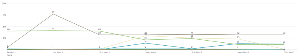

Currently I use this search:
index=Linux | search host!="test*" | timechart span=1d count by HCS | timewrap 1w
To get the following result:
But as you can see, there are some results with 0 because of the count. I want to exclude everything that is zero.
I thought of something like this:
index=Linux | search host!="test*" | timechart span=1d count by HCS  where count >= 1| timewrap 1w
But that doesn't seem to work.. What would be a correct way of excluding zero values?

I actually want to remove only the zero values, so >=1 should be ok. Should've stated in the title. But anyway, when using your search (With >=1 or >1) I get the same results, only the results that where higher than 1 previously are now all 1. So for example the 77 on november 2th is now 1.. Not sure why the results are being modified to 1?

No problem, I indeed want the results to not show 0 so >=1 or >0 should work. When I show results with 0 the line chart and legend of the line chart get really cluttered with unusefull data. So that's my reason get rid of them.
You mean like this?:
index=Linux HCS "NOT OK" | search host!="test*" | bin span=1d _time | stats count by _time,HCS |timechart span=1d count by HCS where count > 1| timewrap 1w
Then all results are still 0 or 1. Results with more than 1 are changed to 1.. Not sure why?
Thanks for your assistance!

This works indeed. Both with and without timewrap. But can you explain why _time and HCS is in count and in the next pipe, you count HCS again?
Thanks a lot!
Sukisen1981
Champion
The point is if you apply a straight timechart without the stats command, you will get an output with time as first column and the names of the HCS field from column 2 onwards.
Now, that is not what you needed. the key here are the bin and the stats commands.
the bin is used to split time into 1 day intervals. the stats counts the HCS values against the time split of 1 day each.
Remove all code after the stats and see the output, you will get 3 columns, _time, the field names for HCS and a third column 'count'.
Now , I simply take the values of the count, values(count) and apply a timechart.
The reason why my first code was just giving you 1 or 0 is because i was using timechart count, which was merely counting the count (occurences) of the stats command output and not the values of the count as you wanted.
I am sure if you see the output till the stats command after removing rest of the code , you will understand.
