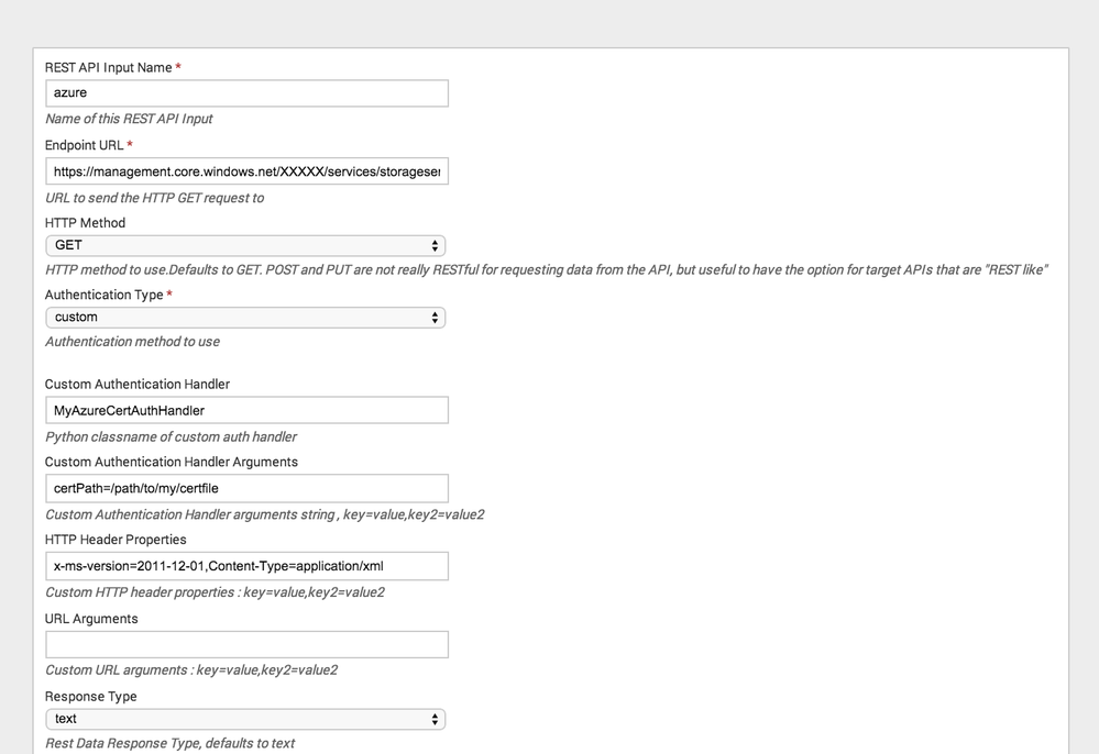

Then your setup might look like below. I don't know why you were using the http proxy setting , I've stripped that out.I also added HTTP Headers because it said so in the documentation I read.

inputs.conf
[rest://Azure]
auth_type = custom
custom_auth_handler = newazurecert
custom_auth_handler_args = certPath=/Users/sdange/Documents/Apps & TA/Azure/newazurecert.cer
endpoint = https://management.core.windows.net/XXXXX/services/storageservices/satishsplcs1
http_header_propertys = x-ms-version=2014-10-01,Content-Type=application/xml
http_method = GET
index = azure
index_error_response_codes = 0
response_type = text
sourcetype = csv
streaming_request = 0
