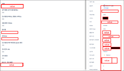

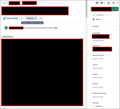

Example here... The Client value is always a value. However, as shown in the images, the customer value does not exist.
[Error Ticket]
[Normal Ticket]

Is there any pattern between the ticket type and the values appearing? E.g. does the Customer value always appear in Normal Tickets but never in Error Tickets? Or does it look random?
Also when you say that "In Splunk, it is confirmed that the value exists", can you say it definitely exists for all records, even for the tickets that say it doesn't exist? Try running your alert search, but looking for rows where the field does not have a value.

The client value is a value that always exists and is confirmed in splunk, but the value is not received in the error ticket. In addition, other values ​​(time, reason) cannot be received.
Currently, I am receiving multiple values ​​such as customer, time, reason, etc. as a Jira custom field, but I am wondering if even one value is incorrect (e.g. when the reason field exceeds the length limit), I will not be able to receive all mapped values.

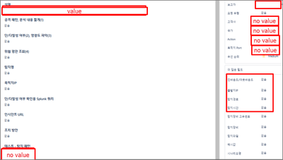

However, I created a custom field with the same type (multi-line) as the Jira description field and tested it by entering the same value, but the value was not received only in the custom field. Example photos are below:
[normal ticket]
[erro ticket]

In the error ticket, all parts mapped to Jira customfield (e.g. "customfield_10211": "$result.client$") are not included.
In regular tickets, customer values, time, etc. are always present, but in error tickets, none of the values ​​mapped to customfield are coming in, even though they are confirmed in Splunk.
If there is a problem with even one customfield value, can I not retrieve other values ​​as well?
(For example, there are two Jira custom fields, client and reason. However, the reason field is a single line type, so there is a length limit. If the length limit is exceeded, i will not be able to retrieve values ​​from not only the reason field but also the client field...)
