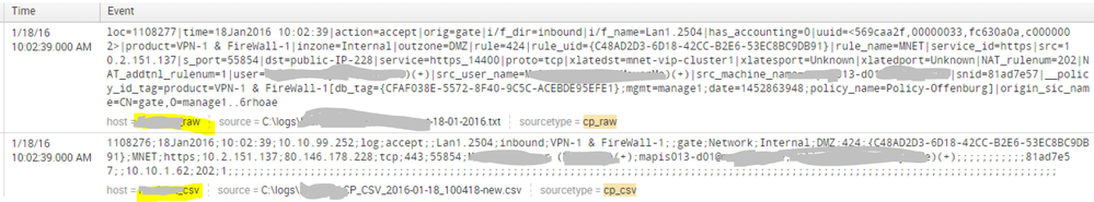

Here is an example:
  1. The log file on the Check Point management server is CSV based, there is no overhead from writing key value pairs in the event. Writing key=value in each event will increase the log volume.
  2. Lots of information are missing in the log file, as you can see, the data from the OPSEC TA script is enricht with some additional fields. Thats the second point that causes more log volume.
At the end these two things are the reason why there is such a big difference between the size of log files on the disk of the CP Smart Center and those generated via TA OPSEC.
It will definitely be helpful if TA OPSEC will provide a delimiter based event structure just to save some volume.
