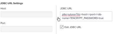

It was not Credentials itself. It was a problem with encryption. With following JDBC it is working:
jdbc:sybase:Tds:<host>:<port>/<db-name>?ENCRYPT_PASSWORD=true

Could you provide little more details like which configuration file you change that on?
klowk
It was only an adjustment in the JDBC String directly in Connection setup in DB Connect
