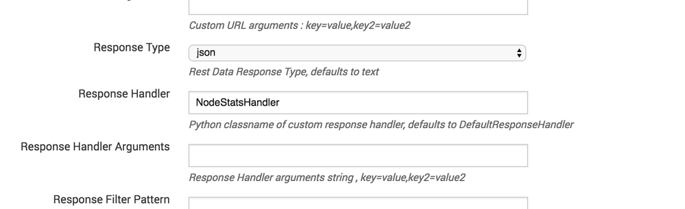

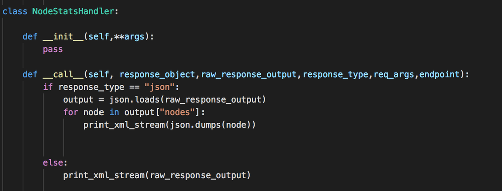

You do not need to use props.conf or TRUNCATE settings.
A more ideal solution is to declare a custom response handler to split out the raw received JSON into individually indexed events.
There are several examples in rest_ta/bin/responsehandlers.py
Here is a pseudo example for your use case

Yeah, the handlers are rad, especially when needing to break out arrays and massage the JSON! Only thing I'd like better is jq in the pipeline.
Looks like the LINE_BREAKER had them set up easy enough though. Most customers end up going that route regardless of me showing them the handler. The coding can scare them away. Not all admins have the chops/want to deal with the handlers....but if you do....they are a great option to have!
