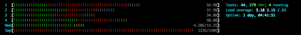

After some investigation, I have discovered that the HF is chewing through its entire Swap disk, whilst the physical (well, virtual) memory is max ~4gb of total available.
I have been debugging this issue on a variety of ec2 instance types (c5.4xl/2xl/xl) and the system memory/core count has no impact on the behaviour.
The behaviour of this was such that the swap file located on the / volume would be heavily written to, this is in turn would eat the available IOPS on the volume, which when depleted cause high IOwait and eventually the system becomes unresponsive.
To check if this was a problem with the process needing a high amount of virt. mem for the initial ‘read’ I have moved the instance to an m5d, which provides an ephemeral 140GB ssd, which I have used as a dedicated swap device as it is not IOP limited (except by the underlying hardware device). As predicted, this has solved the IOPS depleting and the iowait condition is prevented.
The box has a steady load avg of ~3 (yes I know it’s only got 4 cores) but is otherwise quite happy.
However, the S3 python process has consumed 124GB of Virtual Memory, of which 123GB is on Swap.

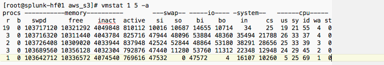

Hi @PavelP
Thanks for your suggestions, see the results of vmstat and iostat below.
As you can see this is real swapping, (vmstat formatted for clairty)alt text
And in iostat you can see the highest io is on the dedicated swap device nvme2n1

just to be sure and not to confuse the virtual memory allocation and active swapping (=paging): do you actually see active swapping? Use vmstat or iostat (part of sysstat package):
vmstat
iostat -xd 1
If there is no active swapping (constantly many MBs/s in vmstat or about 99-100 %util in iostat output) for a long time then there is no need to worry.
