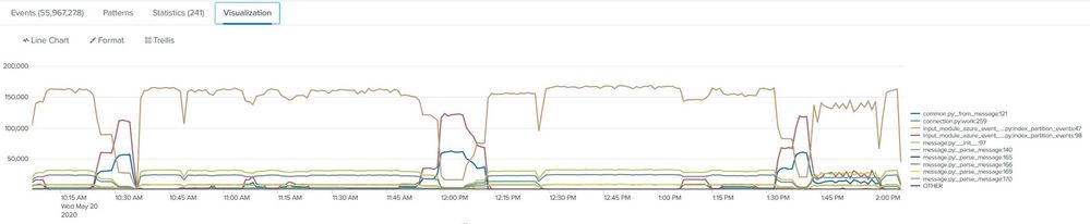

It seems like it may be storing a lot in memory before forwarding to the indexers.
lots of activity in the parser, very little in the indexer.
