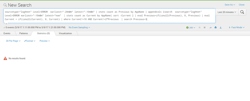

I have made an email alert. but when i click to view events on triggered alert i see no results. why this happens? how can i show the results?

Your trigger times in the capture show 12:27 to 12:34 but your search shows 1:11 to 1:21. Is it possible that there were no triggered events between 1:11 and 1:21? What if you change your search time frame to the 12:27-12:34?
sonila
I tried but no result again
